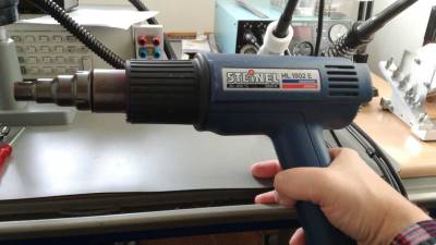

A hot air pistol may also be quite useful for de-soldering - if used with caution. Measure the true temperature with a thermometer or a PT100 / PT1000 resistor and an ohm-meter. Cover areas that shouldn't be de-soldered with heat resistant material such as aluminium or capton foil.
Hot air pistol used for de-soldering - see text
