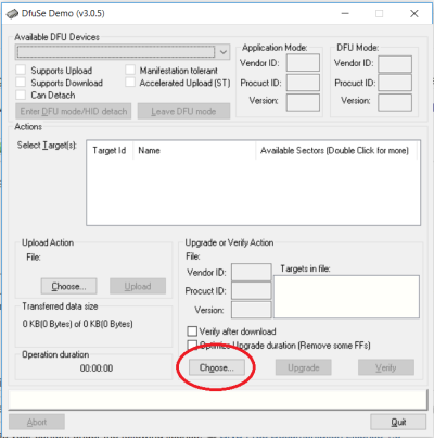

- Use DfuSe Tool to load new firmware. Use the “Choose button marked in picture to select new firmware to upload, not the other one. Then use Upload and Verify button, then quit
