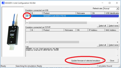

As part of the Segger J-Link SW pack the “J-Link Configurator” utility. In Windows it can be started using the Windows start menu
Segger J-Link Configurator - Firmware update tool

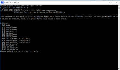

Segger provides a “STM32 unlock” utility as part of the standard J-Link SW pack. The tool can be started in Windows using the “start” menue and resets all values to factory default:
Segger J-Link STM32 unlock utility
Note: The unlock utility resets the brown out reset (BOR) to “level 0”, equalling about 1.7 Volt.

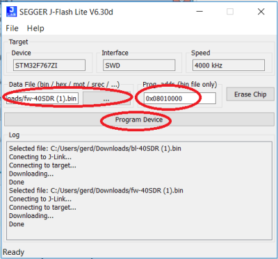

As part of the Segger J-Link SW pack the flash utility “J-Link lite” is provided. Start J-Flash using Windows “start” button. Note: J-Flash does not support .dfu files. Use the UHSDR .bin files. Load bootloader at address 0x08000000 and load firmware at 0x08010000.
Segger J-Flash Lite tool
